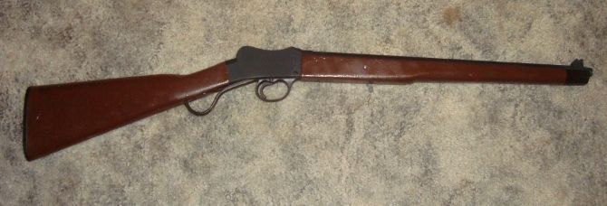

Have put in a better photo but from Photobucket as Picassa, for some weird reason is sending original pics even though they've been cropped. :evil:

The finished product except for the action pin and the rere sight.

Good to something being revived like this .

Looks good, Eoin. Now....are you going to shoot it and let us know how it does punching holes in paper?

Definitely, I'm working on the sight now.
The rifle was stamped .32/20 on the barrel and I thought that it was one of the many thousands that were re-chambered for that round (mainly the rim grouve was deepened) but it won't accept a .32/20 so was probably so stamped to make it look legal in the times when the .310 was deemed to be a military calibre in NSW.
The trick was to turn the rims on a few .32/20s so that they'd go into the chamber (if it was lose enough) and "Yes, Officer, it's a .32/20, see this .32 Winchester round slips straight in". :)
The .310 is a better and more powerful round anyway in modern re-loadings.
