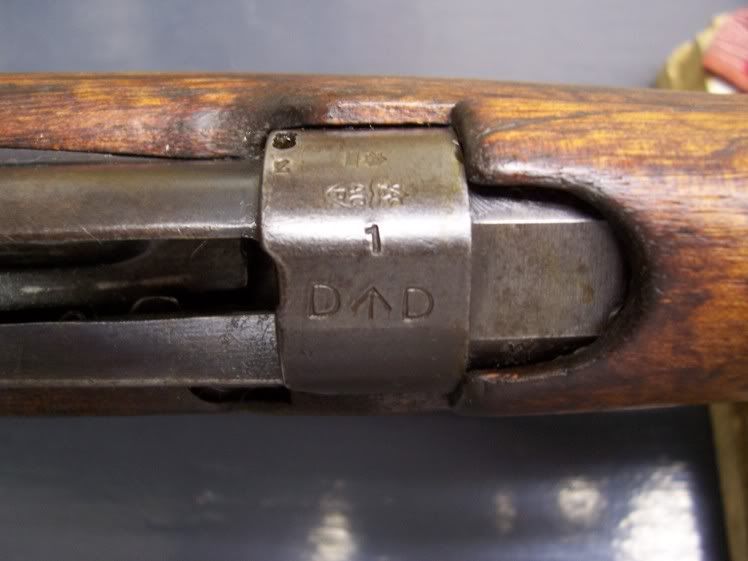

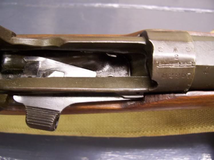

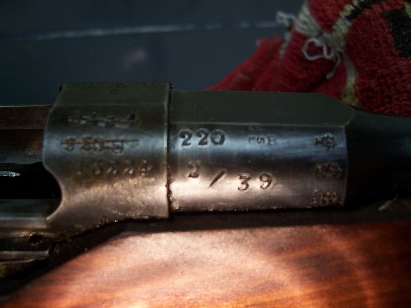

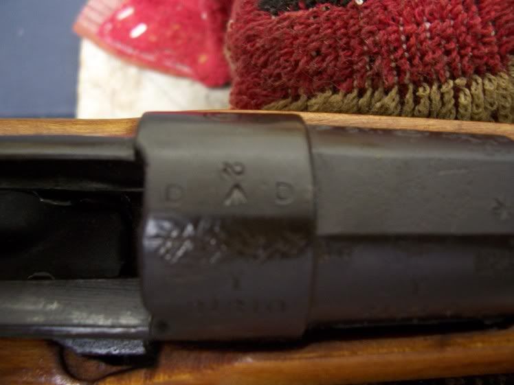

i have a 1917 LITHGOW , it has markings 2.M.D stamped on it . 2nd military district( eastern command , new south wales) i also have another lithgow that has
2
D^D stamped on it whcih is ( australian downgrade arm , 2nd class reserve ), and also have 1908 enfeild with 2
D^D on it that was a 303 then made into a .22 trainer in 1939.
Do your rifles have 2.M.D on them or 2
D^D and are they australian .
2

the rifle with 2 M.D , 1917 lithgow i have is in new zealand , so i can not supply a picture has any one got one with the M.D marking that they can post.any feed back on the above markings??

YE , thats it . goes from 1st M.D to 7th M.D. does anybody know what the marking on the first picture on this thread means W17 ??
Uhhhhh.....
"W 17" is the serial number of the rifle.
A further note on the "downgrade" marks.
If they are truly "downgrade" marks and not just a later form of Military District mark which omits the "M.D."....
1.Why do I have rifles running "1 over 32117", "2 over 119225", "3 over 10553" and "5 over 17801"? Why would a "downgraded" rifle be numbered "1"...or "5", for that matter?
2.Why are there what appear to be inventory numbers accompanying the "1,2,3 and 5"?
Of the four rifles in question, three are British SMLEs, reworked circa 1919 and then sent to OZ. The "5" rifle is a 1920 Lithgow.
Two rifles (1 & 5) also carry the numbers on the buttstock, just as the earlier "M.D." rifles do.
"2" does not have stock marks and "3" is not wearing it's original wood.

can you take some pictures .
could you post the pictures and i will ask brian labudda, on the 20th may at the next gun show he is the guy that helped ian skennerton right the lee enfeild book .if they are marked 2nd M.D to 7th M.D . they must be australian .? if they are marked D^D with 2 above or below they are downgraded . your ones that have 3,4,5 . i agree that they would not be down graded that low they would have been scraped or stamped DP. But the ones you have with numbers 2,4,5 and do not have M.D stamped after them how can they be military district ones??i am not here to make bad blood between us i am just intrested to find out what the story is ..i have never seen these marking like this before , and have not seen W17 before so am intrested in info on them
