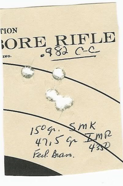

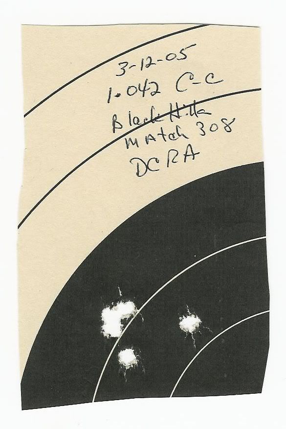

Range was 100 yards.
This is the longest rang I have available. Elmer.
