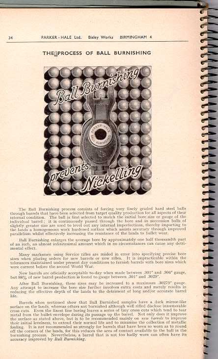

AJP Ball Burnished Barrel
My 1953 No 4 Mk II was one of a batch delivered to Parker Hale from Fazakerley for conversion into target rifles and it has a ball-burnished barrel.
When I bought it it had had a Mk 1 military rear sight fitted so I bought a PH 5C aperture sight to return it to original condition.
When researching ball-burnishing some kind person on a forum sent me an article which I have added below. The print is a bit small but is readable at a pinch.
  http://img.photobucket.com/albums/1003/ ... nishpg.jpg" style="border:0;"/><!--EZCODE IMAGE END-->
Hope this is of interest,
Brian

Re: AJP Ball Burnished Barrel
Brian,
you are <!--EZCODE ITALIC START--><em><!--EZCODE BOLD START--><strong>the</strong><!--EZCODE BOLD END--></em><!--EZCODE ITALIC END--> man, thanks for that, I hadn't seen that article afore. ;
I presume that your No 4 is a tack driver as well.
