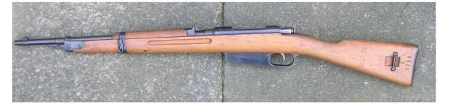

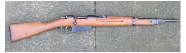

I am still waiting for the paperwork to collect my M1941 Carcano so I thought I would post a few pics of my M38 in 7.35mm. It is a nice handy rifle if a little, shall we say, unsophisticated. The clips I have are not the best and cause a few feeding proplems. Anyone know a source of Carcano clips in the UK? I have never seen another one of these on the range in the UK. Does anyone else have one?
A few pics.
http://img.photobucket.com/albums/0703/ ... lright.jpg[/pic]
http://img.photobucket.com/albums/0703/ ... llleft.jpg[/pic]
http://img.photobucket.com/albums/0703/ ... action.jpg[/pic]
The butt with the stamp to tell you that it is not a 6.5mm rifle.
http://img.photobucket.com/albums/0703/ ... 38butt.jpg[/pic]
The fixed sight with calibre marking.
http://img.photobucket.com/albums/0703/ ... 8sight.jpg[/pic]
Barrel stamps. They stamped the proof marks over some original marks. The arsenal is Terni. The Roman numerals next to the date signify how long Mussolini had been in power.
http://img.photobucket.com/albums/0703/ ... 8marks.jpg[/pic]
http://img.photobucket.com/albums/0703/ ... 38date.jpg[/pic]
http://img.photobucket.com/albums/0703/ ... rkstop.jpg[/pic]
The slot in the barrel band and stock is to take the blade of the folding bayonet.
http://img.photobucket.com/albums/0703/ ... etslot.jpg[/pic]
I am looking forward to getting the 6.5mm to go with this one.
Peter

Neat weapon, most of the ones I have seen were pretty grungy looking.
Can anyone think of any other fixed sight rifles from the same era?
If you can't find any clips over there, let me know they seem to be available here anywhere from $2 to $6 a piece.
