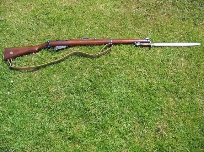

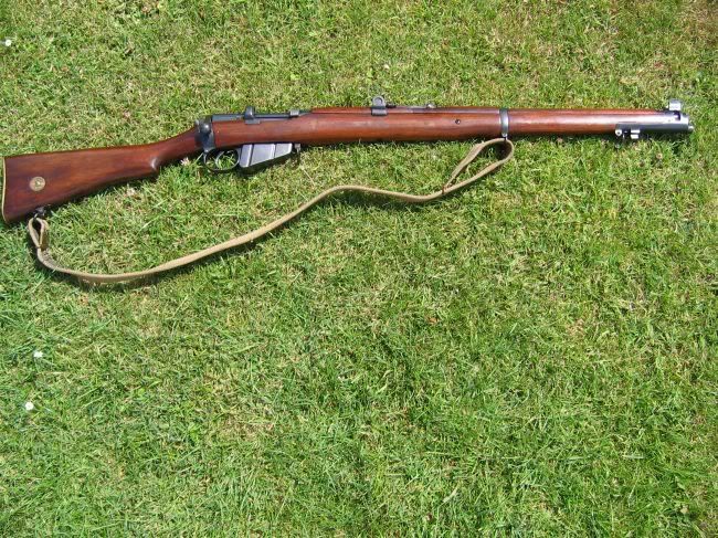

The rifle is in very good condition and has clearly been in private rather than military ownership for most, if not all, of its life.

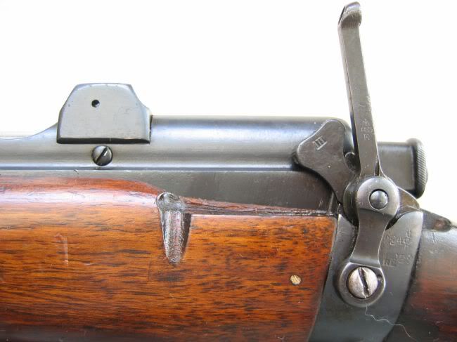

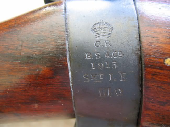

The action is from a 1915 BSA No 1 Mk III*

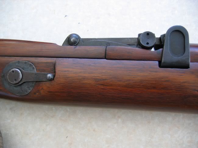

Unusually, the rifle is fitted with volley sights which normally would have been removed during conversion.
Unfortunately, a small piece of the fore end has been broken off where the rear volley sight fits.

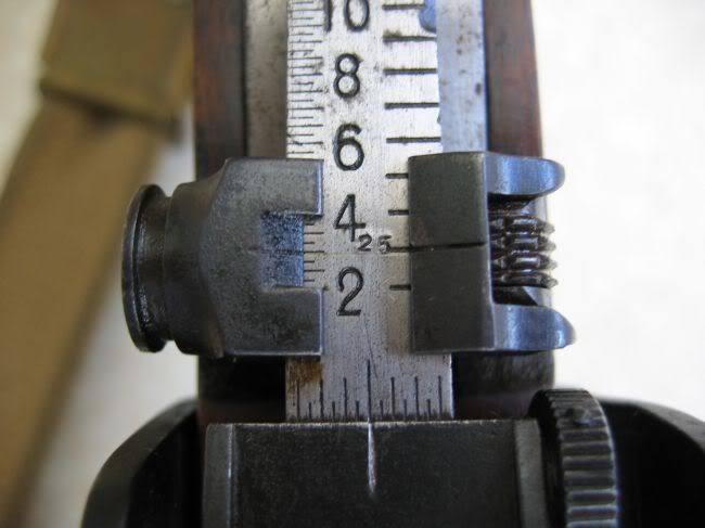

This shot shows the 25 yard mark engraved on a standard sight leaf. A windage adjustable element is fitted.

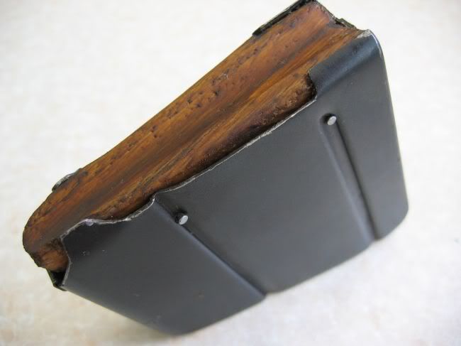

The magazine would originally have been an empty casing that simply collected the spent rounds but someone has fitted a wooden follower that is pinned through the casing.

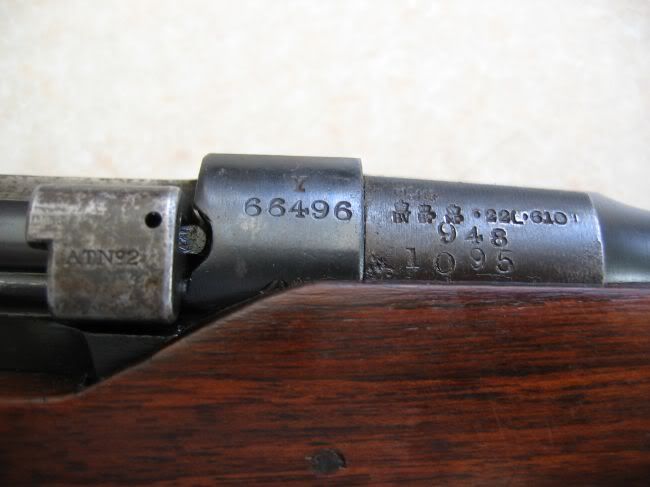

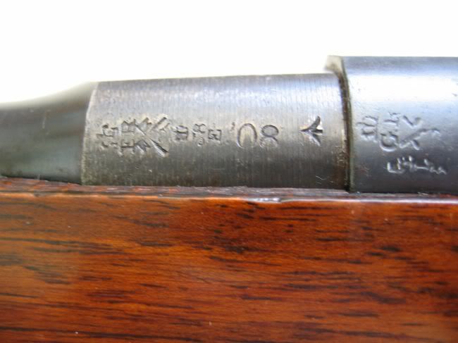

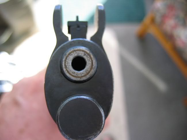

The barrel was a shot-out 1908 .303 that was drilled out by AG Parker and fitted with a "Parkerifled" tube. Later conversions had purpose-made, solid .22 barrels. The sleeved barrel on my Bonehill Martini is seriously accurate so I'm hoping for similar results with this rifle.
Here you can see that the action and barrel serials do not match. (The bolt and action serials do match)
This view of the muzzle clearly shows the barrel liner.

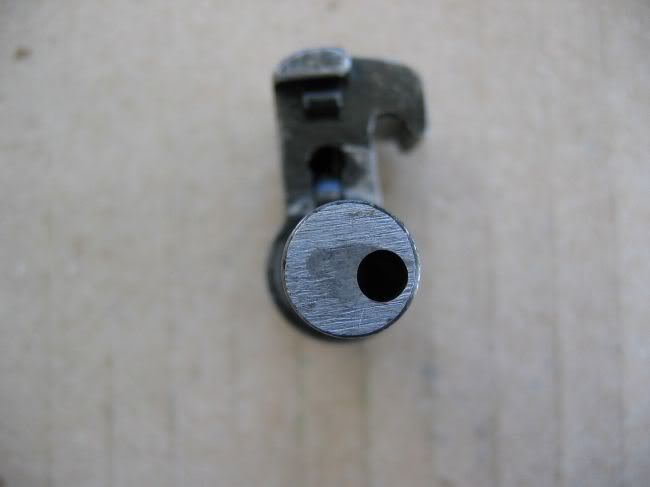

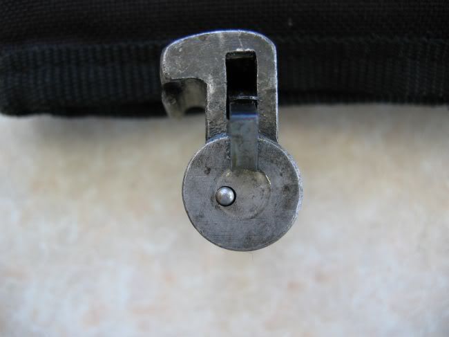

This front view of the bolthead shows the offset firing pin
And this one of the rear shows the hole for the floating firing pin.

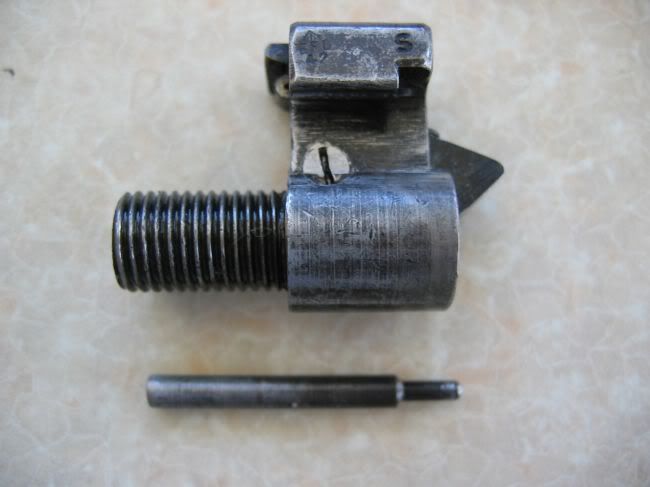

This shot illustrates the short firing pin. The needle-like tip of the original .303 firing pin was ground off and the resulting flat face now strikes the rear of the .22 pin when the trigger is released. A clever solution to the problem.
