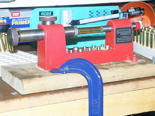

Trimming the cases, the actual length isn't that important so long as they are all the same length and have the mouths squared for an even crimp, case length is supposed to be 2.105", all my new Winchester cases were less than this with off square mouths so trimming was a must.
http://img.photobucket.com/albums/1003/ ... 70HL14.jpg[/pic]
http://img.photobucket.com/albums/1003/ ... 570HL6.jpg[/pic]

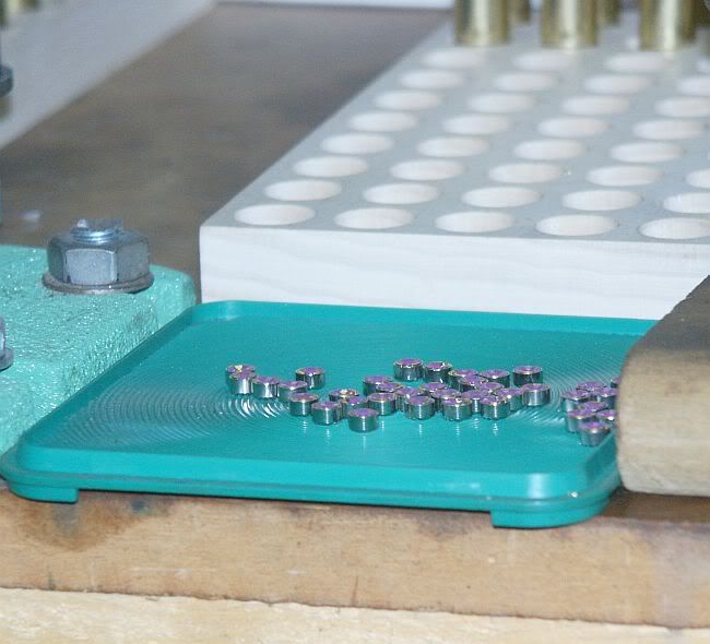

Federal 215 Large Rifle Magnum primers.
http://img.photobucket.com/albums/1003/ ... 570HL4.jpg[/pic]

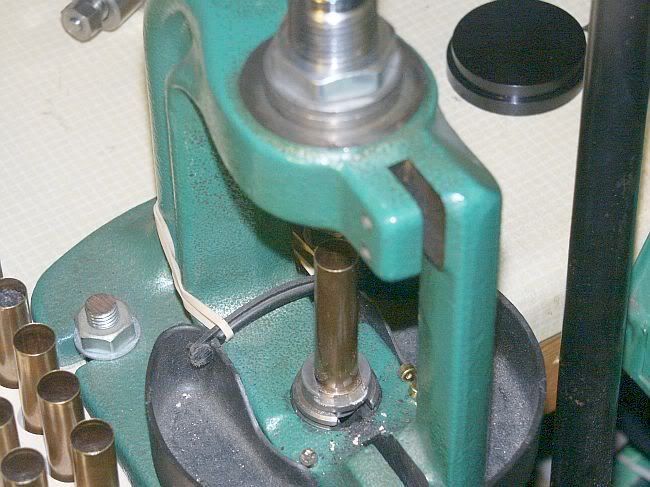

Repro of the contemporary Pope capper/decapper, main use is to decap the cases on the range before they get tossed into a bucket of water. However in the spirit of the original I use it to prime the cases as well.
http://img.photobucket.com/albums/1003/ ... 570HL5.jpg[/pic]

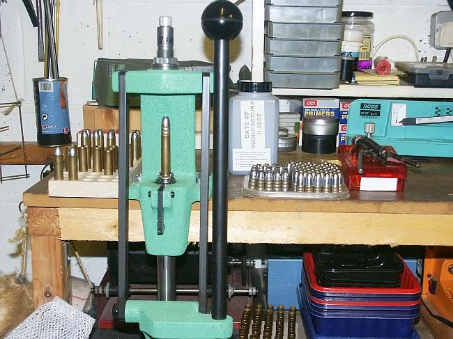

Compressing the powder with a compression die is next, this has to be done so that when the bullet is seated it just sits on the powder, air gaps are supposed to be avoided in the interest of safety. If you use the bullet to compress the powder then the bullet will deform as it takes a bit of effort to compress the charge. The Rockchucker makes light work of it.
Here the first 11 cases are compressed the next 10 are charged but not compressed, you can see how far into the case the powder must be compressed.

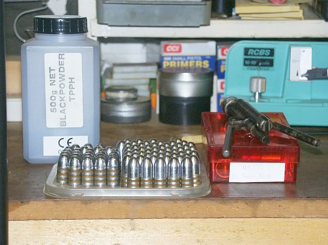

Bullet seating next, Lee 405 grainers on the left SAECO Postells on the right. 30-1 lead tin mix. TPPH Black Pwder can be seen in background on the left.

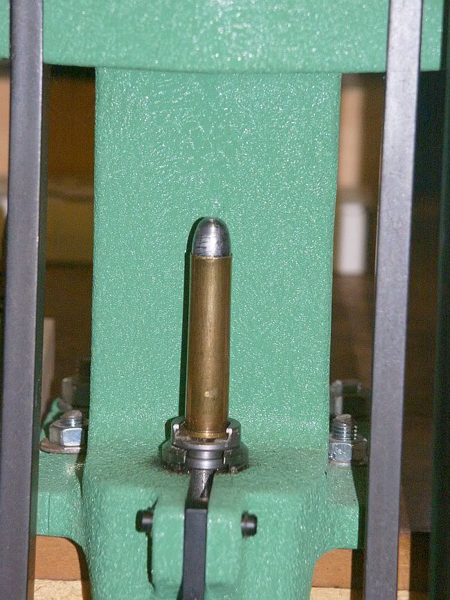

Bullet seating, Lee 405 grainer first
http://img.photobucket.com/albums/1003/ ... 70HL33.jpg[/pic]
http://img.photobucket.com/albums/1003/ ... 70HL30.jpg[/pic]
http://img.photobucket.com/albums/1003/ ... 70HL31.jpg[/pic]
http://img.photobucket.com/albums/1003/ ... 70HL32.jpg[/pic]
