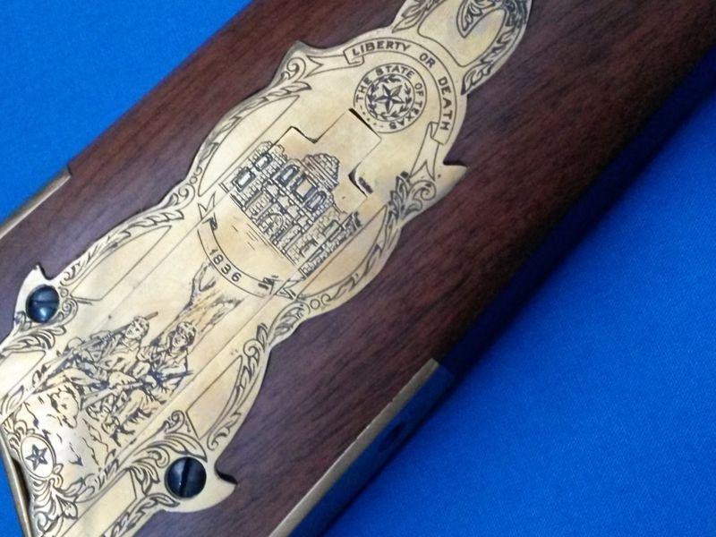

Hello all,
Bought this Pedersoli Alamo in cal .45 a couple of weeks ago in Germany.
I took it to the range twice and it shoots just great (just a bit low).
I’m still testing different loads and patches.
Tomorrow I’ll take it to the range again and instead of a .445 roundball I will try a .440 roundball, 0,25mm and 0,31mm patches and BP loads from 42 up to 45 grains.
The powder I use is German Wano PP.
I’ll let you know how the rifle performed tomorrow evening.
A couple of pictures off course.
