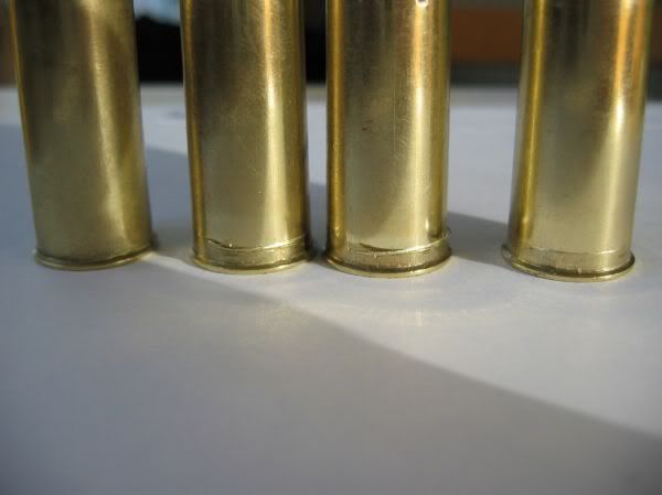

So far I had only been able to fire 13 of my 40 CBC cases that I had incorrectly primed with large rifle instead of large pistol primers. I pulled the rest. When I tried to size the fired cases I ran into problems.
http://img.photobucket.com/albums/1003/ ... dcases.jpg[/pic]

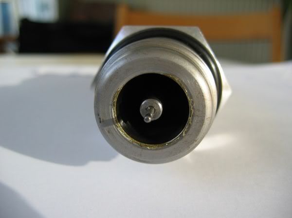

As you will see if you look closely, the die has shaved metal off the base of the cases where they have bulged slightly.
http://img.photobucket.com/albums/1003/ ... avings.jpg[/pic]
Here you can see brass particles in the mouth of the die.
I was naturally concerned that all this indicated a serious fault with the rifle so it was with some trepidation that I set myself up at our 50 metre range.

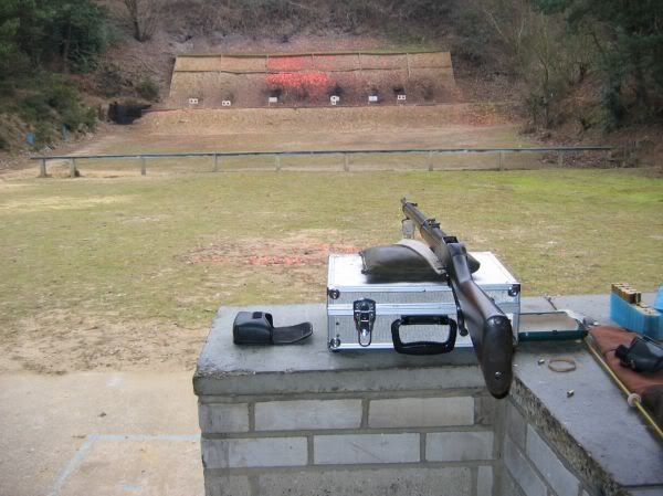

http://img.photobucket.com/albums/1003/ ... gpoint.jpg[/pic]

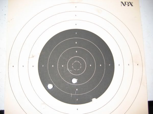

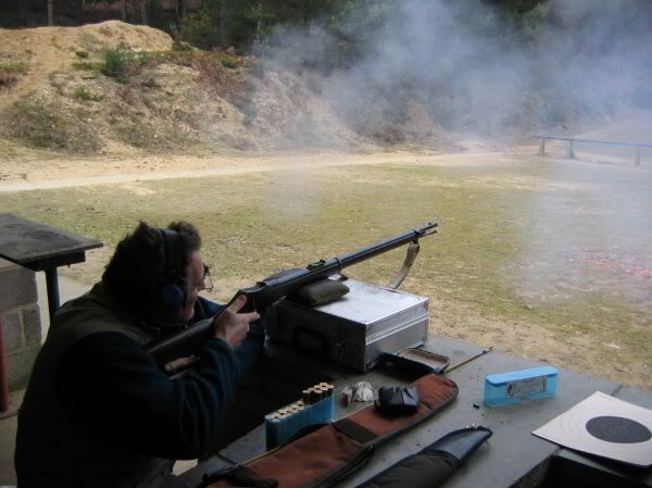

There are eight target positions and I'm shooting on number 5 from the left. I've stapled two targets one over the other so as to use the lower one as an aiming point and, hopefully, to hit the upper one.
http://img.photobucket.com/albums/1003/ ... ismoke.jpg[/pic]
To my delight I had no further light strike problems with these rounds, this shot being number 13 in a pretty rapid series. I managed to chronograph two rounds at 1363 and 1325 fps respectively.
When I checked my original target I found that a plonker on the next bench had been shooting at my target, would you believe with a 45/70 Sharps so there was no way of telling which shots were which.
http://img.photobucket.com/albums/1003/ ... target.jpg[/pic]
Here are my final four shots. Two of these (I don't know which) were slightly downloaded with 85 grains BP and a small over powder wad of tissue paper. (Round four is at 7 o' clock in the 5 ring and difficult to see)

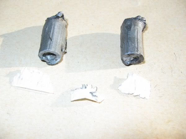

When I closed the range I raked the backstop and recovered these two bullets. They are well mangled but clearly show the imprint of the distinctive Henry rifling. In front are three scraps of paper patch that I picked up just in front of the firing point. I didn't find any cardboard wads.

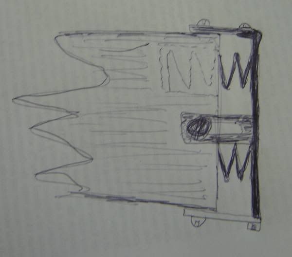

What a great post. I thoroughly enjoyed it. I've been a fan of the Martini Henry for years, but unfortunately let all of mine go over the years.
The last that I had was a commercial military model, by Tisdall.
It had been modified by having a 'recoil reducer' fitted to the butt.
About 1/2" had been cut off and the stock drilled to take two car valve springs, the butt plate was held to the stock by four slotted strips of steel which allowed the butt to move back and compress the springs during recoil.
Can't say how well it worked as I never fired it.
.http://img.photobucket.com/albums/v174/ ... C00752.jpg[/pic]
Just dashed up a quick sketch.....it's the artist in me :roll:

The damage to the cases is unusual to say the least.
You may have a an over size chamber but even so the sizing die should size the case down alright.
What make of die are you using and what sizing lube are you using?
The opening of the die could perhaps do with a bit of radiusing.
In saying all this is FL resizing really necessary?
Neck resizing should give better accuracy anyway, all you need to do is back off the die a bit 'till it isn't sizing hard to the base and sizing the neck of the case only. You can use a felt tip pen or Zippo soot on the case neck if you want to see how much you are sizing, all you need is enough of the neck sized to give a bit of bullet retention and so long as the case chambers you won't need to FL resize.
What was the issue with the primers BTW?

I've had a lot of problems with the Martini-Henry over the past three weeks since my bullet mould and brass finally arrived from America and my post is just edited highlights of my travails.
Firstly, the CBC brass is reformed from 24 gauge shotgun shells. These have pockets designed to take large pistol primers but nobody thought to mention this to me and I primed them with Federal magnum large rifle primers. As pistol primers are shallower than rifle primers mine projected from the pockets instead of being recessed below the base. Oops!
Second, these cases are quite thin, have a chamfered rim that is .001" thinner than the original and are of "balloon head" construction. This means that they hold a lot more powder than the originals - 115 grains to the top of the shoulder.
I was advised to use 85 grains BP topped up with 30 grains of 50:50 BP/Cream of wheat (semolina) as an active filler. My first time at the range I fired seven rounds that all went off with a definite, high pressure "crack" and then I had a succession of light strike misfires.
On my second trip out I managed to shoot six rounds before the same thing happened. At this I decided to pull the remainder and start again.
One of the problems is a low firing pin strike. To rectify this, metal needs to be stretched in the operating lever arms but before doing this my gunsmith mate suggested that I try some Kynoch cases. Mr Little of Kynoch advised that I use ordinary large rifle primers in his cases and not the magnums I'd used previously.

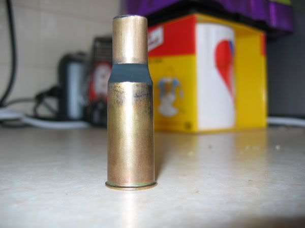

When I tried to resize the fired cases I noticed that they had bulged slightly and that's when the case shaving took place.
This morning Gert and another guy on the Martini forum suggested I adjust the die to neck size only and this was the result.
http://img.photobucket.com/albums/1003/ ... edcase.jpg[/pic]
I think I've got it about right. I previously thought that you needed a special neck sizer and wasn't aware that the FL die could be so adjusted. You live and learn, eh?

Post by dromia » Fri Feb 17, 2006 2:34 am
Hi Brian,
just another though on the case deformation in the die.
Are you sure that the case shellholder is in line with the die?
Amongst my Snider shell holders I have an old NDFS one that won't sit fully into the ram and consequently puts the case into the die off centre, it manages to hit the decap pin alright but as the base goes up its get harder to size. I'm sure that if I persisted then the cases would look like yours.
Just a thought.

85 grains of BP and 30 grains of 50/50 Cow in a CBC case. No big deal really in nice drawn solid head cases. But too much for the balloon head CBC cases.
85 grs. and one of the fiber fillers is just fine. But stay away from the solids such as CoW.
