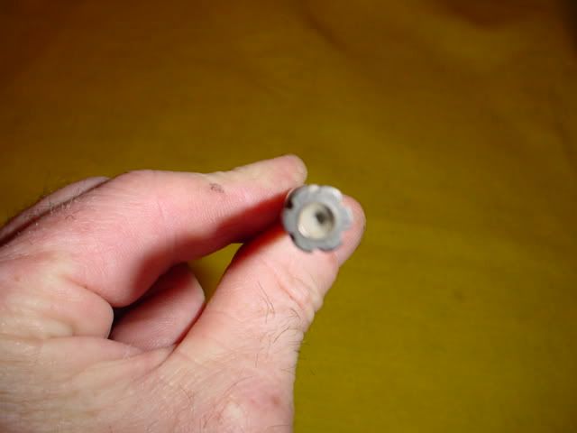

Post by wheaty » Wed Mar 05, 2008 9:23 pm
Six grove barrels were manufactured in Canada using the broaches from the Bren gun barrels. Normally they were used on the later No.4's dated in the 49 to 52/3 run, but some have also surfaced on late 45... Here is one of the broaches used for the Bren barrles
http://img.photobucket.com/albums/v76/6 ... C00023.jpg[/pic]
Post by dromia » Thu Mar 06, 2008 1:40 am
Now that is an interesting geegaw for an Enfield collection.
Thanks for sharing. :D
