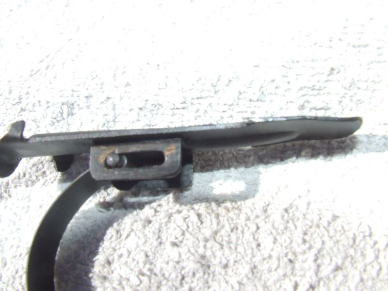

Whilst sorting through a pile of 303s from Holts I happened upon an incorrectly fitted magazine. My research (limitted to a couple of books) puts it as possibly an MLE magazine. It has a platform I assume for Mk6 or earlier ammo and the spring sadly detached is a C form rather than a W form. the botton edge of the magazine is curved more than the one for the SMLE and in the pics it is shown next to that and a Savage one for a No4.
The magazine also has the two holes for the eye to secure the mag via the chain to the rifle. What do you folks think and can it be restored. I think I am missing something that should go on the lip at the front but barring that can it be done?
Sorry about the pics

Restorable if you can find another magazine spring. Your's is broken; the end is folded to form the attachment to the magazine body. These days it's well worth restoring one of these increasingly rare (around here anyway) magazines.
