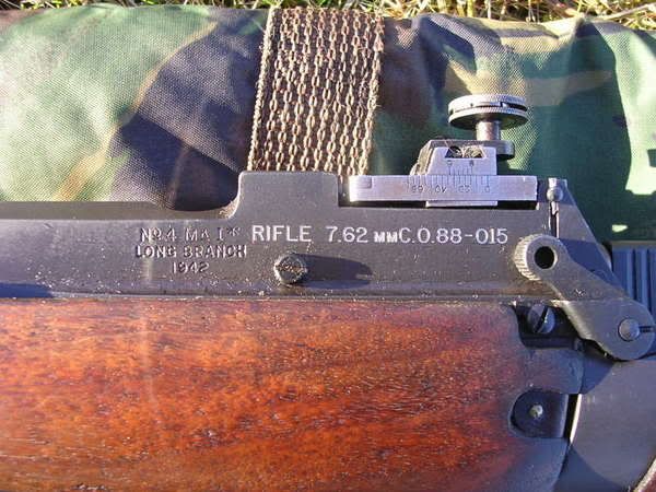

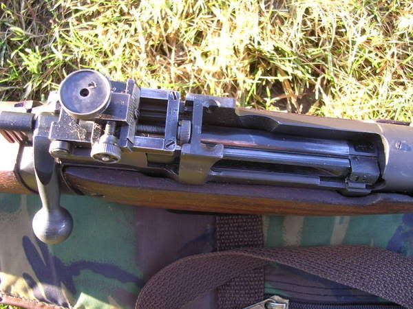

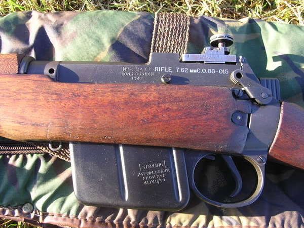

Any Chance of a picture of one of these rifles?
Post by Niner » Wed Sep 07, 2005 6:49 pm
I'd be curious to see an example.

Post by joseyclosey » Thu Sep 08, 2005 12:21 pm
Posts: 11910
Thanks Joe
Post by Niner » Thu Sep 08, 2005 1:15 pm
There is an article in the current Shootgun News about exchanging the standard Mk1 site for the windage adjustable sight. What they are showing in this story looks just like the sight on the rifle you show. The one in the article comes from Sarco for about $49 and is said to be surplus that was originally installed on a version of No. 4 in .22 rimfire.
