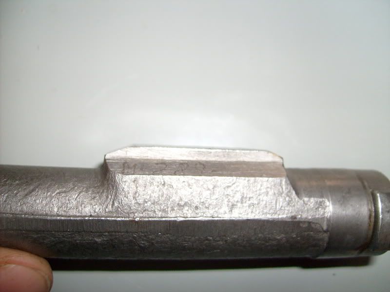

well folks here is my own design for a semi auto mg42
bolt conversion it's about 1/2 done at this point
first thing to do is to grind off the full auto sear from the bolt (red arrows)
http://img.photobucket.com/albums/v315/ ... arrows.jpg[/pic]
Ground off and beveled.
http://img.photobucket.com/albums/v315/ ... 300424.jpg[/pic]
